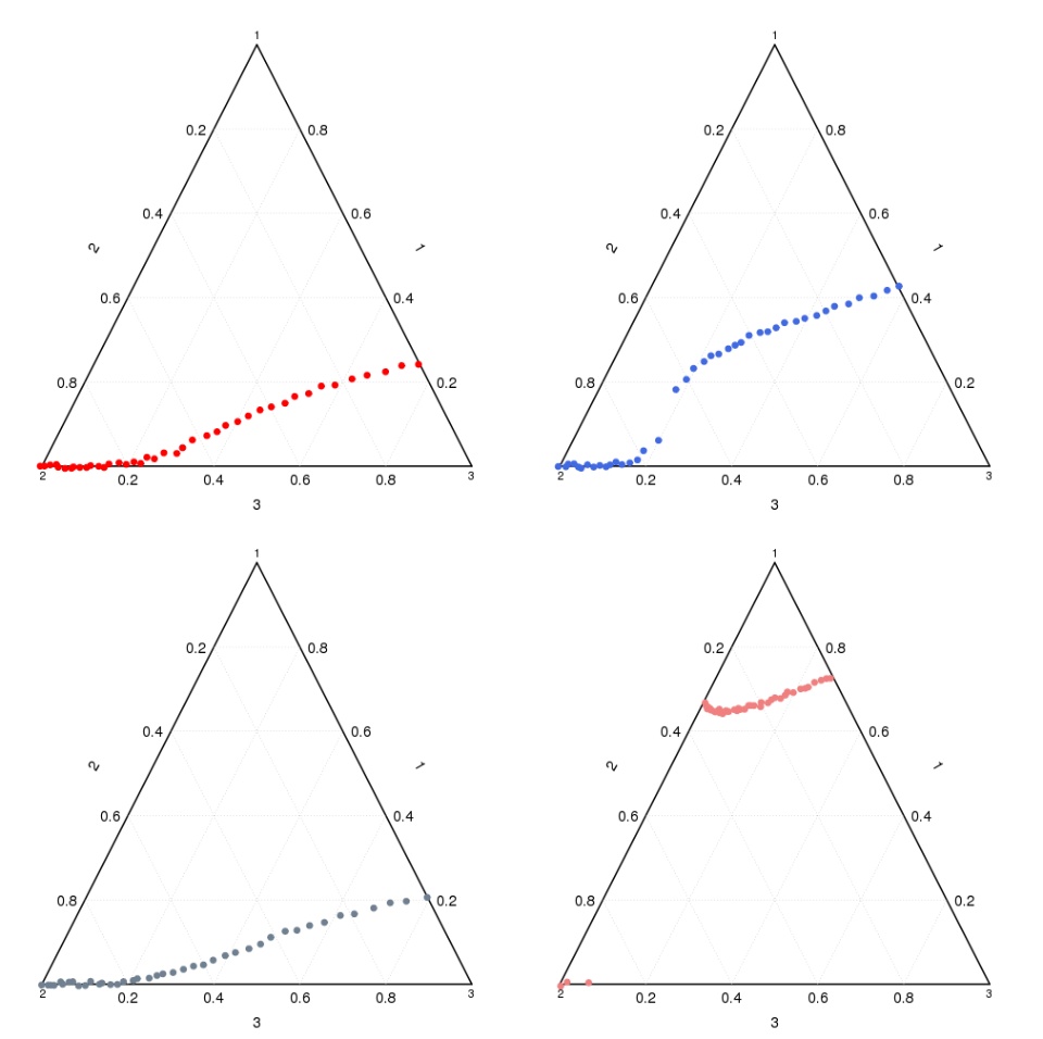

This is maybe beyond the scope of the component and more of an R scripting problem - I have very little R experience - but... Is it possible or has anyone managed to adapt the "R mixture Plot" component to plot multiple data sets on the same plot?
Ideally, I'd like overlay these four plots but so far haven't had any success

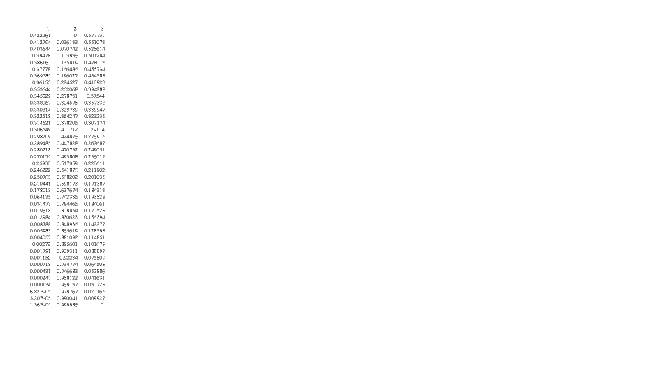

Input data attached.

Murray,
I did not see an attachment with your data, so I am attaching a protocol with some fake data to show how to do this. Basically, you send all data sets into the component, and define a color property with a different value for each set. Then set the "Color Property" parameter on the component to the name of this property.

P.S. Oddly enough, after I replied, I was then able to see your data attachment. I also attach a picture of the output I get from my example. (It seems only one attachment per message is allowed.)

P.P.S. And here is a protocol that uses your data. I added a symbol property in addition to the color property. (It appears that two of the datasets are identical.)
