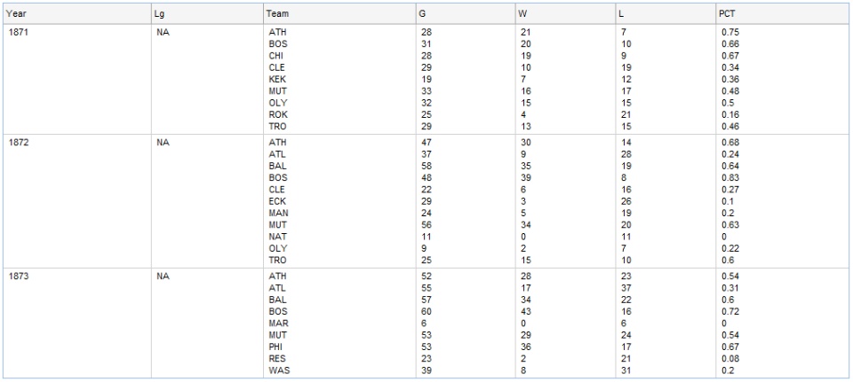

Purpose: reduce the display space of a table containing arrays!
The standard table component in the reporting collection produces nice, but large tables such as the one below.
The idea is to collapse arrays into nested tables and let the end user uncollapse/collapse those while browsing the page.
The "collapsable nested table" let the protocol designer chose which properties to group in the nested table and provides plus/minus tiny icons to uncollapse/collapse individual tables.
