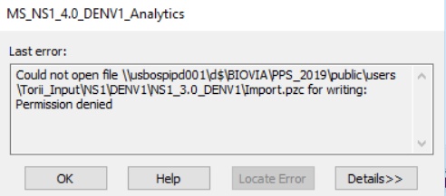

Hi,
i am trying to run a protocol and getting a permission denied error. Previously the protocol is working fine. Please provide some help.
Thanks in advance!
Hi,
Thanks in advance!
HI Pranjal From the file path, it looks like you are trying to write to Users folder within PLP 2019 version. Can you check the settings of the Impersonation in the Admin Portal (Admin Portal -> Security -> Authentication)? Alternatively, if the server of the file location and PLP 2019 server is same, then you can define the location as $(userdir) or $(publicdir).
