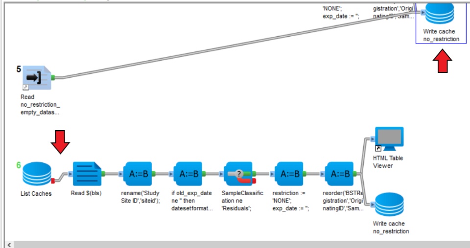

Is there way for the 'List Caches' in the lower left corner to recognize that the 'Cache ID'(no_restriction) it is looking for does not exist (fail port)? Therefore, continue with the 'Reader' component. On the other hand, if the 'List Cache' found the 'Cache ID' (no_restriction) then nothing will happen. Will appreciate any help!
The picture below for reference.

There are maybe more elegant ways of doing it but I'd just make a global variable after the list cache then have a new pipe starting with a filter asking is that variable is defined then the reader

Here is an example subprotocol component.

Thank you Keith and Murray for providing the solution. I combined both methods into the Pipeline!
