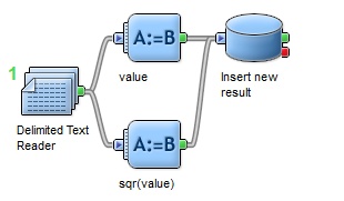

I've been struggling quite a bit inserting numbers into an Oracle table using PP8.0 and the ODBC driver 6.0.
Basically, I'm computing the square root of some data and inserting both the data and its square root in a table.
I'm many occasions - not all - the number inserted is not the actual value's square root, but the value of the previous data record.
For instance, I have the following numbers: 20.2, 9.1, 18.4. Therefore, I should insert 20.2, 4,4944..., 9.1, 3.0166..., 18.4, 4.2895
Once inserted in the table, I read: 20.2, 4.4944..., 9.1, 9.1, 18.4, 18.4. It replicated the values instead of inserting the square root value.
I found that formating the value prior to insert it does work.
my_value := format("%9.5", my_value);
The table contains proper values: 20.2, 4,49444, 9.1, 3.01662, 18.4, 4.28952

Looking at your diagram it is not easy to discern what is going on inside of your Custom manipulators.  I have attached a basic example which I think is doing what you are, and this works fine for me.  I'm wondering if you can run this example and tell me if you still see this issue.  If not, then we can look at your specific example and try to see what is going on.
Both Michael and Jeremy have brought up some good points.  If you are doing what Michaels suggests and have different data types for different records this could cause an issue.  I haven't seen his exact issue before so I am not sure how it would fail.  As for Jeremy's point, the SQLDescribe param is responsible for Type Casting data coming in from an external source (Pipeline Pilot) into an Oracle database.  So in some cases when you are having data type problems this is the culprit.
In either case, I still can't reproduce the problem at hand, so I think trying to run this example may be the best way to go.  Then we can take it from  there to see if this is a bug, or something that can be corrected in your protocol.  All you need to do is specify a Data Source.  A test table will be created and then deleted after displaying the data.

Custom components only sets the value_name and computes square root of value.
Then the insert state is extremely simple: insert into my_table (id, value_name, value_numeric) values (myseq.nextval, ?, ?)
I didn't answer to Jérémy's post, but yes the driver is properly set. I ran into issues he's describing years ago and addressed them.
What I'm describing is really weird in the fact that it sometime properly inserts the value and sometime insert the value of the previous record, it never crash or stop.
I'll try your protocol and let you know.
Pierre

Hi Rob,
I ran your protocol. Indeed, it does work. Commenting out the ChangePropertyType line make it fail with the following error message:
Property "value" has different types in different data records (was SciTegic.value.StringValue is now SciTegic.value.DoubleValue)
Interestingly, although the miss inserted value was the square root (second record), the problem came from the initial value.
The first record has a value of 0 and it's type is set to String, the second record has a value of 356.3 and is considered a string as well.
type_0 := GetPropertyType(value, 0 );
valuetype_0
0String
0Double
356.3String
18.876Double
If I change the first record (in the file) to 0.01, it is still read as a string by the delimited text reader.
Shouldn't we consider this as a bug in the delimited text reader?
