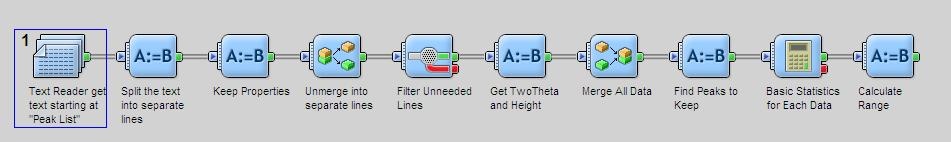

I am having trouble importing specific columns from a text file. As of now I can only import the first two columns. If I try to import a 3rd column farther down the list, it draws from the 3rd column from the text file instead of the column of my chosing. Here is a snipet of my raw data.

I want to be able to take the first 2 columns 'Pos.[°2Th.]' and 'Height [cts]' , as well as the last three columns 'h', 'k' and 'l'. The last three columns 'h', 'k' and 'l' need to be merged into one data set so it is not treated indivudally.
Here is a simple breakdown of what I have so far:
Looking forward to the responses.
