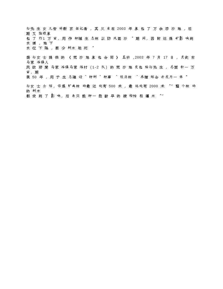

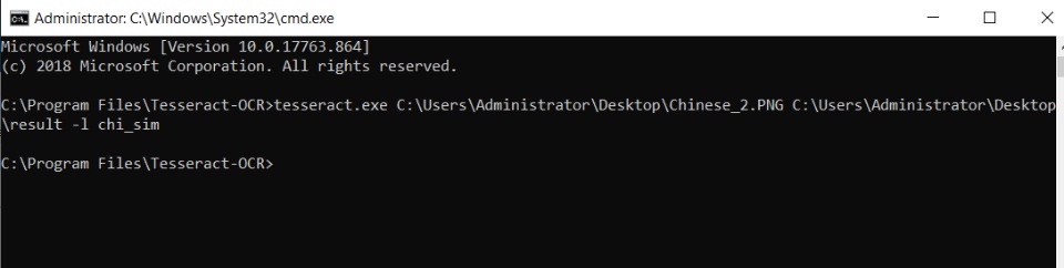

I want to recognize Chinese_Simplified from a image. I can capture these Chinese from images using tesseract by CMD command. However, when I integrated tesseract with Pipeline Pilot, I just can get the number and English characters from image, cannot recognize Chinese characters.

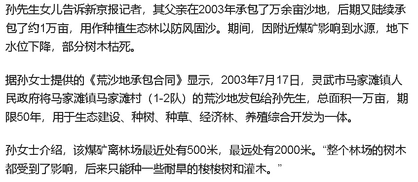

Testing image:
CMD Command:
OCR Result:
