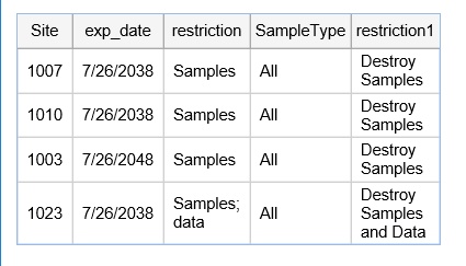

How to merge in loop?
I have 2 tables(sample dataset and a restriction dataset attached in the post) that I need to merge on site id. Is there a way that I can loop through the restrictions and merge with sample dataset at the same time? Whatever samples that did not merge with a restriction the first time will merge with the next restriction. Until all the restrictions are apply to samples. For samples with site id that is not in the restriction, the restriction will be none. Will appreciate any inputs. Thanks!
Sample dataset:
sampleid sampletype subjectid   siteid
a1111     WB               11111    1007
a2222     Serum          22222    1010
a3333     Plasma         33333    1003
a4444     WB              44444    1023
a5555     Serum           55555    1007
a6666     Plasma         66666    1010
a7777     WB               11111    1007
a8888    Serum            33333   1003
a9999    Plasma           99999  1005
result:
sampleid   sampletype   subjected   siteid      exp_date   restriction1
a1111      WB                 11111         1007    7/26/2038   Destroy Samples
a2222     Serum             22222         1010    7/26/2038   Destroy Samples
a3333      Plasma           33333          1003   7/26/2048   Destroy Samples
a4444    WB                   44444          1023    7/26/2038   Destroy Samples and Data
a5555     Serum             55555           1007   7/26/2038   Destroy Samples
a6666    Plasma             66666         1010    7/26/2038   Destroy Samples
a7777     WB                  11111         1007    7/26/2038   Destroy Samples
a8888     Serum            33333          1003    7/26/2048   Destroy Samples
a9999     Plasma           99999           1005   7/26/2038   None
                       restriction dataset:
