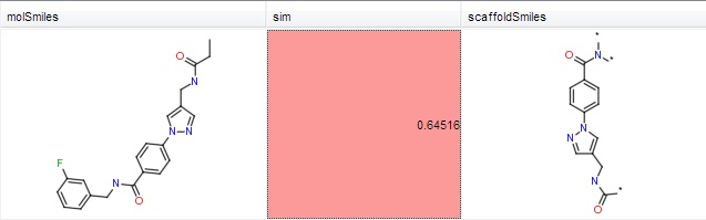

Does anyone know of a way to improve the calculated similarity between scaffolds containing R-groups and molecules which do not contain R-groups?
I've experimented using the Tversky coefficient and various fingerprints but still can't acheive similarities that are as reflective as hoped.
For example using the scaffold as the query with beta=0 in the Tversky coefficient applied to ECFP_8 fingerprints
Example 1a)
I would have hoped that since the scaffold is a direct substructure of the molecule, the similarity would be much closer to 1, and I understand that it is the scaffold R-groups that are the issue
Changing [*] to [R] or [H] does not improve the situation

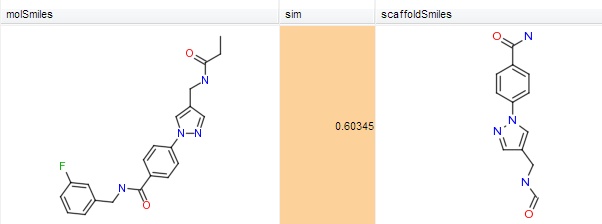

Example 1b)

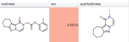

Example 2)

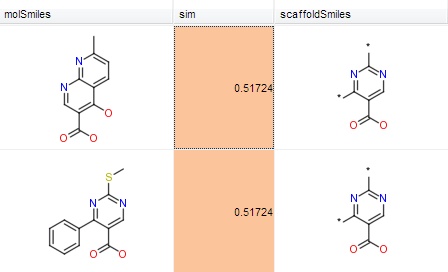

Example 3)
