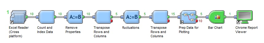

I have a protocol that works fine but it includes two transpose components to allow me to get my data how I want it. This works fine for small input files but I do have cases where the input files can be very large (10,000+ rows). In these cases the protocol can take hours to run due to the amount of data being transposed.
The protocol basically calculates the difference between 5 sequential lines and repeats for the entire range of data.
ie (A1-A2)+(A2-A3)+(A3-A4)+(A4-A5)
Transposing the input file and using an ithproperty(#i) Loop is an easy enough solution but creates a bottleneck with larger files.
I'm sure there will be an alternative or just a better way to script this. Any input would be very much appreciated.
