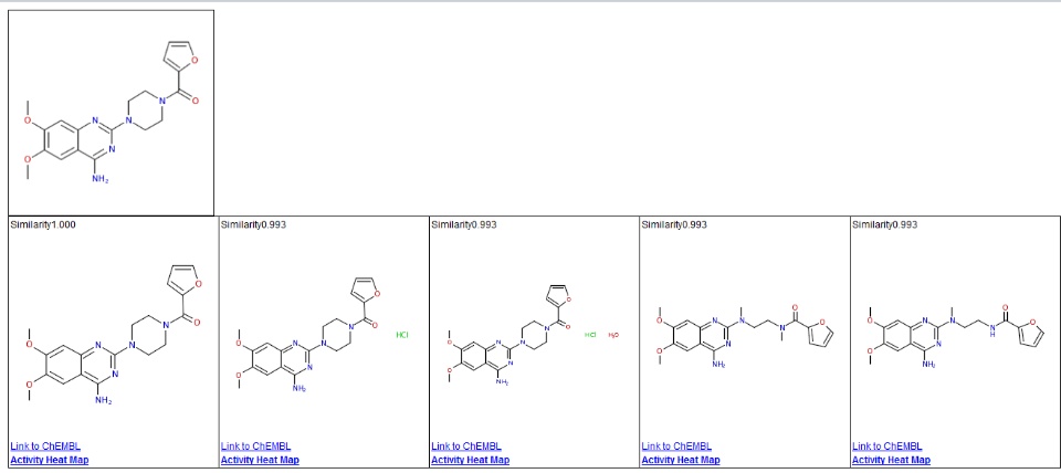

Inspired by a a colleague who wanted to see activities of her compound in ChEMBL, and I tried to make a one page visualization. The original protocol does similarity search, but hie release doesn't (no webservice for similarity). I also wanted to use the webservice available so I have access to the latest ChEMBL data all the time, plus it is as quick as a query.
Please find the attached protocols that allows the users to draw a compound, do an exact search on ChEMBL, display activity heat map for this compounds per target/per organism, or per target only; give the possiblitiy to display article title and activity related to the cells in the heat map.

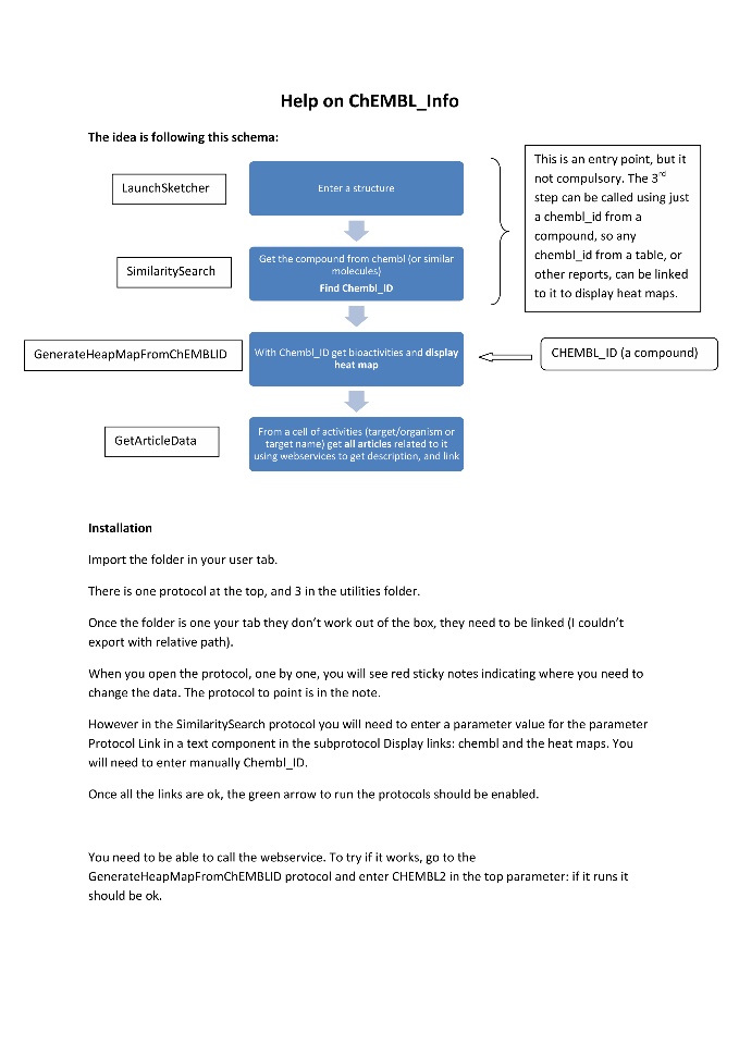

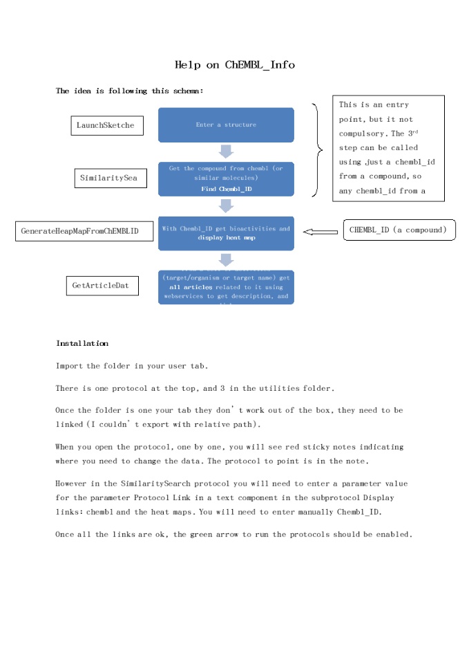

Please read the Help document to get more info
USAGE:
Import the protocol folder into your Pipeline Pilot 8.5 client (or 8.0). And then replace all the protocol links accordingly: see the red sticky notes.
The help file with installation and description is attached.
The following input is required to run the protocol:
Structure or ChEMBL_ID
The heat map protocol requires a ChEMBL_ID and is link to the Article. However it doesn't require the other two protocol to runs if you have already a system to get ChEMBL_ID.

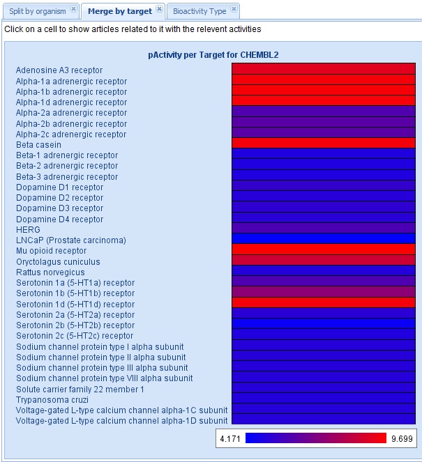

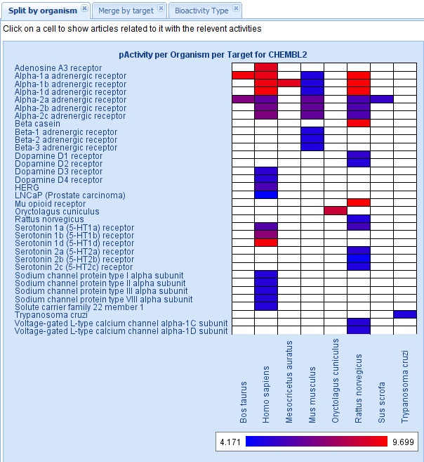

Once a compound is found heat maps are displayed if activities are found for your compound (Ki, IC50, EC50)

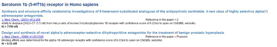

Then click on cell to display articles related to it (title, link, activity, reference of the compound in the paper, target name)
