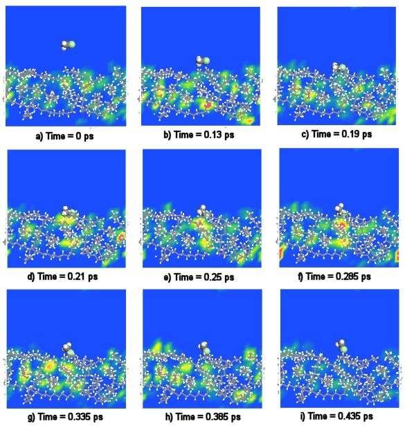

This script calculates the temperature of atoms and displays it as a field. For each field point, the kinetic energy of the atoms within the local region is calculated. From the kinetic energy, the temperature is calculated and this is written to the field point.
An example application of this script is to visualize the temperature field of a set of polymer molecules as a chloromethane is "fired" at the surface. In this example, a polyethylene surface was built using a constrained layer in Amorphous Cell and then equilibrated using the COMPASS forcefield in Forcite Plus. A constant volume, constant temperature ensemble with the Nose thermostat was used for the production run. The chloromethane has an initial velocity of -30 Å/ps in the z direction and a very short run of about 1ps with frames written every 5 fs was used to capture the impact of the chloromethane on the polymer surface. The frames in the figure below show the chloromethane impacting on the surface and show the temperature of the polymer atoms only.
Slices through the temperature field are shown with a mapped maximum of 700K meaning anything above 700K is shown in red. Frames (a) to (c) show the choloromethane descending with no impact on the polymer. Frames (d) to (f) show the impact with hotter areas around the impact site colored in yellow and red. Frames (g) to (i) show the chloromethane bouncing off the surface and the temperature of the polymer around the impact site returning to normal.
