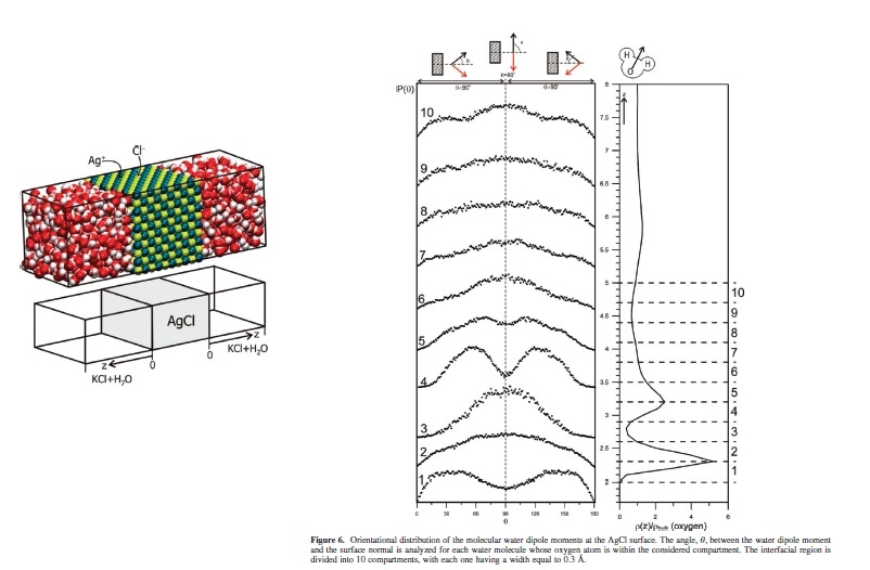

Dear Reinier,
I read your post about "How to measure dihedral angles between two vectors" (Updated Link​​​​​​​)
And I modified the following script according to your recommendation in above post. However, the angle is still between 60-120 degree as Jingjing mentioned before.  If it's available for you, would you please update the correct script?  Following image is the perfect result I am looking for.

The problem is probably in your InProduct function;it has a prototype () indicating the function takes no parameters, whereas it takes two,
sub InProduct(){
my(\$a, \$b) = @_;
return \$a->X*\$b->X+\$a->Y*\$b->Y+\$a->Z*\$b->Z
Deleting () should resolve the problem.
reinier
You need to normalize the dipole moment vector before taking the inproduct, as above,
     # get the direction of the dipole
     my \$dipoleMoment = \$molecule->DipoleMoment;
     my \$direction = Normalize(\$dipoleMoment);
     # calculate the angle between the dipole and the z-axis
     my \$angle = 180/pi*acos(InProduct(\$direction, \$axis));
