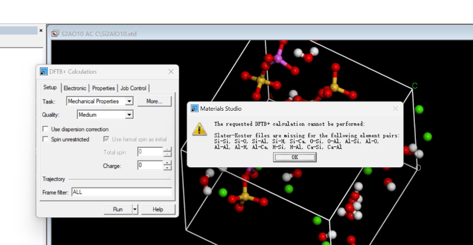

The requested DFTB+ calculation cannot be performed: Slater-Koster files are missing for the following element pairs: Si-Si, Si-O, Si-Al, Si-H, Si-Ca, O-Si, O-Al, Al-Si, Al-O, Al-Al, Al-H, Al-Ca, H-Si, H-Al, Ca-Si, Ca-Al

Did you adjust the Slater-Koster library on the Electronic tab to a library which contains parameters of the relevant element pairs?
On the other hand I tend to say that there is no library available out of the box in Materials Studio DFTB+ which contains the missing element pairs. Edited: at least some even when another library is used.
Please have a look at the "Geometry optimization of a carbon nanotube" DFTB+ tutorial and the "Creating parameters for DFTB+" tutorial.
For further info I only can suggest to carefully read the help, starting with the Slater-Koster files section
Please also check out this URL: https://dftb.org/parameters
