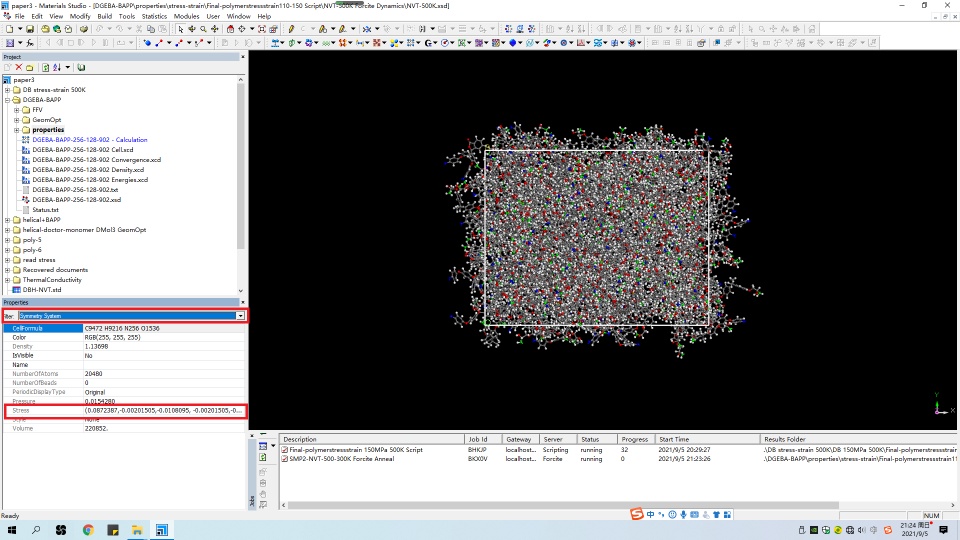

Stress can be obtained by stress-strain script,but how to calculate the stress by frame files

Below is an example which does this.
Basically, copy-and-paste from the Using scripting to calculate the interaction energy between two layers tutorial to loop over the frames and the stress property of a 3D Model Document.

my $symmetrysystem = $InDoc->SymmetrySystem; my $stress = $symmetrysystem->Stress;
my $stressXX = $stress->Eij(1,1); my $stressYY = $stress->Eij(2,2); my $stressZZ = $stress->Eij(3,3); my $stressXY = $stress->Eij(1,2); my $stressXZ = $stress->Eij(1,3); my $stressYZ = $stress->Eij(2,3);
Dear Carsten, may I ask what is the unit of stress obtained here? GPa?
CM
CM2021-12-14
Yes. It is in GPa.
Materials Studio has has a very nice help where this can be found: 1. Select StressXX in the script 2. Hit F1 3.Follow the StressXX Settings as it applies to Forcite Dynamics task link 4. The help page which opens now says: Component of the applied stress (in GPa).
