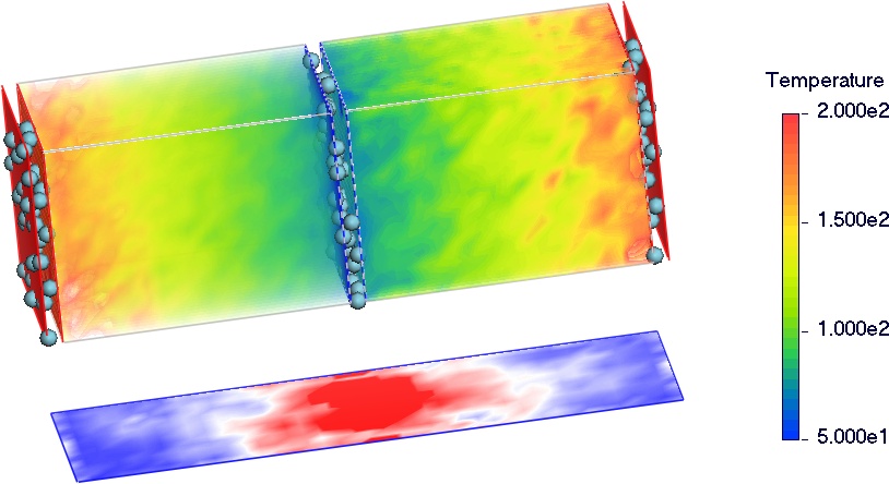

Hi, renee. Thanks for the work.I have a question to consult you.When I calculated the thermal conductivity of graphene, the running result file of the script showed that the energy flow was 0, which led to the thermal conductivity being also 0. How to solve this situation?Best wishes to you.
SZ
SZ 2023-04-19
Hi reinier,
Thank you very much for sharing the script! Really appreciate it! May I ask a question here about the script? I can see there are two setting options here. One is the ObjectType, the other one is the ExchangeType. Since I'm working on epoxy network system, should I choose MOLECULES as the ObjectType? What is the difference between ATOMS and MOLECULES if the system is mainly made by molecules from AC module? About the ExchangeType, could you please also explain a little bit the main influence of the two options (VARIABLE and FIXED) on the result? Thank you very much!
SZ
SZ 2023-06-05
Hi Reinier,
I would like to ask how you output that density profile shown in your figure? Thank you very much!
