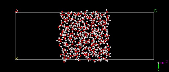

Script for calculating interfacial tension
Dear All,
I would like to share a script for calculating interfacial tension. The script header describes how it works:
# INTERFACIAL TENSION
# Author:     Jason DeJoannis
# Date:     Sept. 23, 2012
# Calculates the average interfacial tension from an atomistic
# or Mesocite trajectory using the stress tensor stored in
# each frame (Stress->Eij). The assumption is that there
# are two interfaces and the box size is fixed.
#    gamma      =  0.5 L < P_normal - P_lateral >
#    L         = box length in direction normal to surfaces
#    P_normal      = pressure in normal direction
#    P_lateral     = pressure in lateral direction
########## USER DEFINED ###########################################
# Surface normal direction X, Y or Z
my \\\$surfnormal = "Z";
# Trajectory with stress tensor
my \\\$doc = \\\$Documents{"water slab.xtd"};
# Begin with this frame number
my \\\$startFrame = 1;
