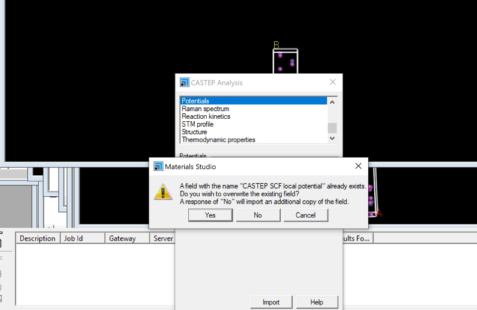

How to tackle this Error in Material Studio "field with CASTEP scf local potential already exist"? I am calculating work function through CASTEP material studio, when i click on the import button to import potential file. This error appears. "field with CASTEP scf local potential already exist".

As it says: the CASTEP SCF local potential field already exists.
The field is either from a previous run or it was tried to import it twice.
The screen shot below shows the third import.
For the second import the No button clicked and it gave SCF local potential field (2) in the Volume Selection dialogue from the Volume Visualization tool bar (upper left corner of the screenshot).
