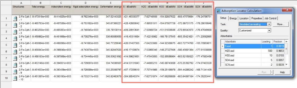

I want to know the meaning of the last few columns (dEad/dNi))obtained after a multi-ion adsorbents simulation on a metal surface. Does it mean the average interaction energy of one ion with the metal surface?
Besides, what's the difference of interaction energy, binding energy, and adsorption energy? As I found these three defination have the same formula.
Thank you!

The last columns contain the "differential adsorption energy" for each of the adsorbates you have included in your calculation. By differential adsorption energy, it is meant the energy associated with the adsorption of a single sorbate molecule on your surface.
The tutorial that can be found in the Materials Studio's help explains the study table output nicely.
This can be found under Tutorials > Adsorption Locator Tutorials > Modeling inhibitor adsorption onto a Pigment Red crystal face. If you don't wish to go through the entire tutorial, the reply to your question is given at the end of it.
