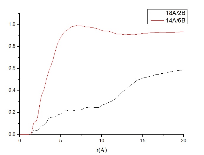

I created a mixture in amorphous cell, which contained 18 A polymer chains and 2 B polymer chains. My current method is to select all A as Set 1, and then select all B as Set 2, and then use the Force-RDF module to obtain the intermolecular RDF of B-B, but this rdf looks very strange.
I also built a blend containing 14 A polymer chains and 6 B polymer chains. His rdf looks normal.
My question is, is this RDF correct? Is there too little molecular chain type B? How much is appropriate?

First I thought that if you analyze only one frame from an Amorphous Cell run this might be normal but I am not 100% sure any more.
Are the two B chains perhaps closer to each other than expected?
What happens of more than one frame from an amorphous cell run is analyzed?
What do you expect to get from this anyway?
Could you please post the A and B monomer and which density was used? to build the cell?
Could you please also post two examples to which you refer?
