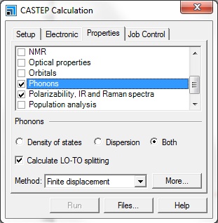

I am doing geometry optimization and Raman spectra calculations for organic crystals with CASTEP program. I am using PBE-D (D - Grimme correction) method.
We recently  updated our Material Studio from 6.0 to 6.1 version and it turned out, that actually CASTEP cannot calulate PBE-D frequencies with default Linear Response Procedure. In CASTEP forum, Dr Keith Refson recommended to use finite displacement method. Unfortunately I don't see this option in Material Studio. Yes, I can specify "Finite displacement" for Phonons (attached picture), but I didn't find this option for "Polarizability, IR and Raman Spectra".
So, when I run CASTEP in Material Studio, Phonons calculations run OK,  but in next step, when it starts to calculate Raman spectra the program exits with  the following error:

If somebody knows how to specify finite displacement method for frequencies calculation using Material Studio?
So far I just manually inserted  the following command in Efield.param file
calculate_raman : true
phonon_method : finitedisplacement
and run it manually (without Material Studio) in my cluster. But I hope there is a normal way to do it.
