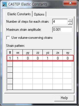

I was tasking elastic constants in CASTEP.
I have little acquaintance with setup tab of elastic constants.
I want to know What Red box means ?
(meaning of (1 0 0 1 0 0) and why enter the (1 0 0 1 0 0) ?)
And If It has above same system, what kind of strain does system have ?
(I think that it has below strain pattern,
                                                        aa     0      0
                                                          0     0    aa
                                                          0    aa     0
but It isn`t like this)
Can anyone give me a hint how to understand that property ?
many thanks,
Lim

Hi Lim,
Your own explanation (which coincides with the help text of Materials Studio and the legend of the dialog) is correct - the strain pattern corresponds to  nonzero xx, yz and zy components. If you look in the results folder, there is a hidden file .cijdat there which for this case would have something like this:
5 4 0 0
       0.003000000000000
       1 1
      -0.003000000000000  -0.000000000000000e+00  -0.000000000000000e+00
  -0.000000000000000e+00  -0.000000000000000e+00      -0.001500000000000
  -0.000000000000000e+00      -0.001500000000000  -0.000000000000000e+00
       1 2
      -0.001000000000000  -0.000000000000000e+00  -0.000000000000000e+00
  -0.000000000000000e+00  -0.000000000000000e+00  -5.000000000000002e-04
  -0.000000000000000e+00  -5.000000000000002e-04  -0.000000000000000e+00
       1 3
   9.999999999999998e-04   0.000000000000000e+00   0.000000000000000e+00
   0.000000000000000e+00   0.000000000000000e+00   4.999999999999999e-04
   0.000000000000000e+00   4.999999999999999e-04   0.000000000000000e+00
       1 4
       0.003000000000000   0.000000000000000e+00   0.000000000000000e+00
   0.000000000000000e+00   0.000000000000000e+00       0.001500000000000
   0.000000000000000e+00       0.001500000000000   0.000000000000000e+00
This is the list of actual strains applied, and they have the symmetry you suggested.

Dear Victor,
Thank you for your valuable feedback but I am sorry about for my unclear question.
please show that below my question.
5 6 0 0
       0.003000000000000
       1 1
      -0.003000000000000 -0.000000000000000e+000 -0.000000000000000e+000
-0.000000000000000e+000 -0.000000000000000e+000      -0.001500000000000
-0.000000000000000e+000      -0.001500000000000 -0.000000000000000e+000
       1 6
       0.003000000000000  0.000000000000000e+000  0.000000000000000e+000
  0.000000000000000e+000  0.000000000000000e+000       0.001500000000000
  0.000000000000000e+000       0.001500000000000  0.000000000000000e+000
First Line of red is (5 6 0 0)
I think that 6 is Number of steps for each strain but I don`t know 5, 0, and 0
What does this number ?
And elastic constant task in CASTEP calculate optimization for each strain pattern force because young`s modulus is measure of the stiffness of an isotropic elastic materials.
It show that .cij_x_x.castep.
Is it right?
And If be used to the CASTEP Analysis tab, you can see the ElasticConstants.txt of same below.
Strain pattern:      1
  Current amplitude: 1
  Transformed stress tensor (GPa) :
       -9.694011       -0.000000       -0.000000
       -0.000000      -11.593645        1.260082
       -0.000000        1.260082      -11.593645
  Current amplitude: 6
      -14.079951       -0.000000       -0.000000
       -0.000000      -12.307091       -1.129289
       -0.000000       -1.129289      -12.307091
then what means red color ?
I need your help.
Thank you.
Best regards,
Lim
VM
VM 2010-12-30
Dear Lim,
The integers in the 1st line, except for the obvious one with the number of steps (as you guessed), contain encoded information about the symmetry - lattice type etc. You should not concern yourself with their exact meaning.
Cij calculation does involve internal geometry optimization for each applied strain - I do not understand your comment about Young's modulus and isotropic materials, it's not relevant to the rest of the question. Geometry optimization is required to mimic real life experiments - atoms always have enough time to react to external stress or strain, thus one cannot ignore their relaxation. If you want to evaluate the effect of relaxation on calculated Cij, you'd have to save input files, then edit every .param file of the Cij series (seed_cij_i__j.param) and change the task from GEOMETRYOPTIMIZATION to SINGLEPOINT.
The extract from the output you included shows the stress tensors as found in the relevant CASTEP results files; these tensors are used for stress-strain fitting and eventually for Cij calculation from those fitting parameters.
Victor
