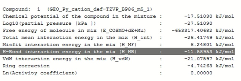

I hope this mail finds you well. We are currently working with protic ionic liquids (PILs) to produce nanocellulose. It is of great interest to determine Kamlet-Taft parameters in ionic liquids. However, experimental determination of these parameters has been challenging as some of the ILs are solids at room temperature.

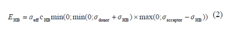

Therefore, through literature research, we came across the paper titled "Extended Scale for the Hydrogen-Bond Basicity of Ionic Liquids," DOI: 10.1039/b000000x where the authors used the COSMO-RS program to determine various physicochemical parameters in ILs like the hydrogen-bond basicity (β).
In this case, to determine the hydrogen-bonding energy (EHB) in the ionic liquids we currently use an equimolar amount, using COSMO-RS. However, once we obtain the results, we are uncertain about which energy value to consider, as the program provides the EHB values for both the cation and the anion. I understand that the program uses the equation shown below for the calculation, but we are unsure whether we should consider the cation or the anion energy (obtained from COSMO-RS) to determine EHB of the IL. For us, it should be the same as is found when is used common ILs, like [c4mim][tf2n] or [c4mim][PF6]. We are not sure if this difference in the EHB is related to the protic nature of these IL or whether we are missing something.

In the paper you cite they mention E_HB as a descriptor. This descriptor is the sum of all hydrogen bonding enthalpies occurring in the mixture, at least to my understanding.
Physically speaking, the descriptor highlighted in your second screen capture represents the total interaction energy caused by hydrogen bonding between the cation and the rest of the mixture. This energy is essentially EHB (that you put in the first screen capture) for all segment pairs involving a segment of the cation with all other segments in the mixture, multiplied by the contact probability. The nice thing about this enthalpy is that it is additive. In other words, to get the E_HB (or H_HB, more precisely) of the entire mixture, per mole, all you have to do is add up the contributions of the cation and the anion weighted by their mole fractions. In the case of an equimolar mixture you simply have 0.5*H_HB_cation + 0.5*H_HB_anion = H_HB IL.
To my knowledge authors do not explain exactly how they proceed to get E_HB as it stands in their paper but physically speaking it makes the most sense to me to proceed as above.
