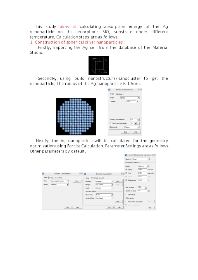

HiThe whole detail calculate parameter ,process, result and the problem are shown in the accessory.The Ag nanoparticle still fly away form the surface.I am very wish to receive your letter.Thank you very much!Best regards
My assumption is that the problem is that there are only vdW interactions between the Ag centers which are not sufficient to hold the cluster together. Together with charge equilibration it well might be that all Ag centers are equally charged (same sign) and that may cause to the cluster to fly apart.
One can try to define bonds between the Ag centers. That would prevent that they fly apart but one would not see any reconstruction of the Ag particle but that would not allow the particle to reconstruct.
Classical simulation which contain metals or transition metal compounds are not always that trivial. Perhaps GULP force fields have some parameters in the area.
