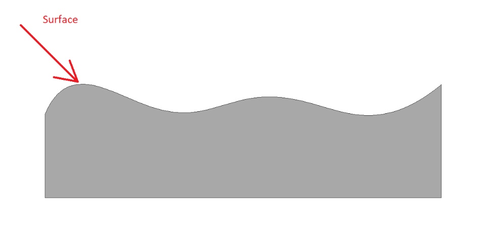

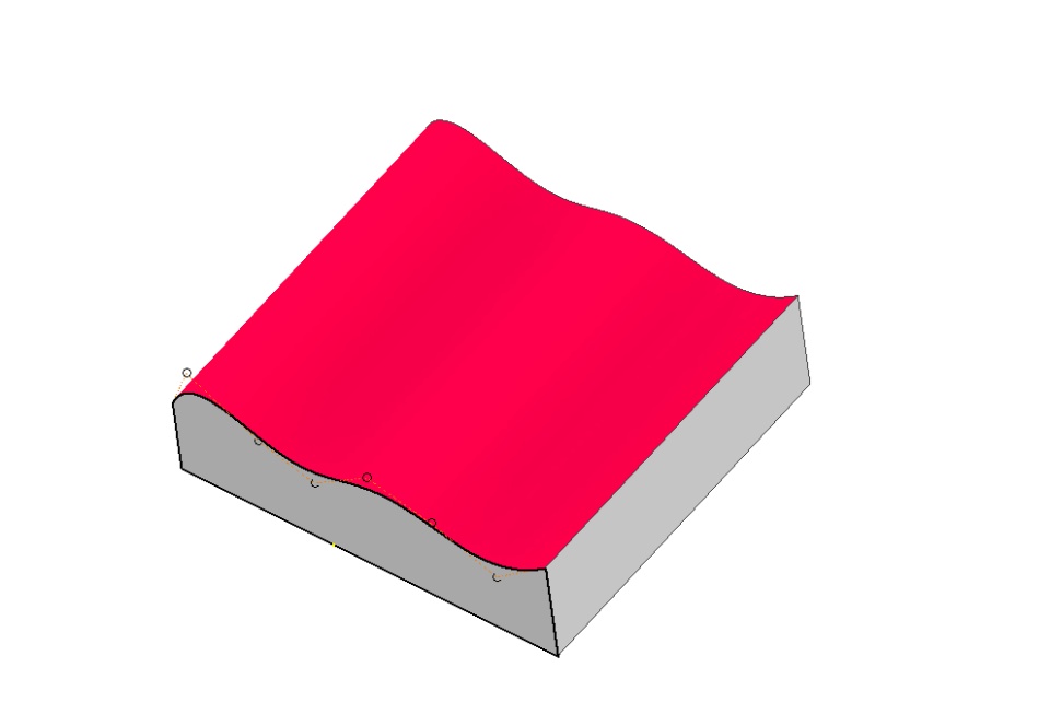

I have a STL file which creating a surface. Now I want to make graphene layers following this surface.
I know ATOMSK can do this but the created graphene layers are not continous, e.g., somewhere Carbon atoms are deleted.
I want to make graphete layers following the surface as continous graphene layers.
Do you know how to do that? By Materials Studio or other sofwares?

What do you mean with continuous?
No dangling carbon atoms?
The contour is some kind of function. The idea I have is to use that function to decide if a carbon center can be deleted y > f(x)
After that loop over all carbon centers and delete all which only have one bond (for loop from n to 1, where n is the number of carbon centers).

Continous graphene layer means that graphene layer is a layer following surface. No C atom is deleted. It looks like flat graphene layer but it follows the surface, not paralel.
The countour is arbitrary.
I think your idear is to make parallel graphene layers, and then delete C atoms which are outside the suface.
