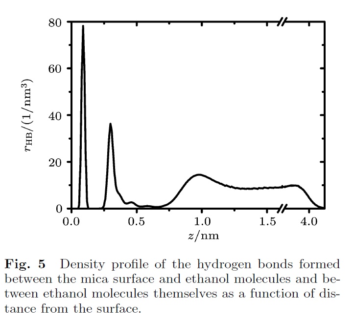

Hi there,
I want to obtain the hydrogen bonding density profile, and as far as I know,  script in this forum can't solve it now. I find an example(zhou bo et al, structure and dynamics of ethanol adsorbed on a mica surface, 57(2012):308-314.) listed as following:
Because there are different hbonds pattern (N O ), I hope we can identify what it is. I will be grateful for any help.
Best Regards

There seems to be two options here:
1. Re-create the concentration profile script where you are basically creating a histogram of hydrogen bond centres at intervals from the surface.
2. Iterate through the trajectory and create a new, trajectory where the centres of the hydrogen bonds are represented by atoms. You can then use Jason's original script to analyse this. Although a little bit of a hack, this should be easier to write - something like:
Open existing trajectory
Create a new empty trajectory
Create a copy of the trajectory frame in a temp XSD
Iterate over the $doc->UnitCell->HydrogenBonds
     Find the hydrogen bond centre
     Create an atom at the hydrogen bond centre
Use AppendFramesFrom to add the temp XSD to the new trajectory
Create set containing those atoms you have added (maybe use a bizarre element)
