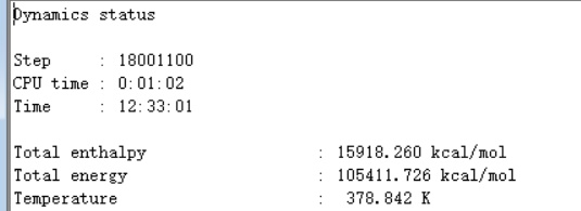

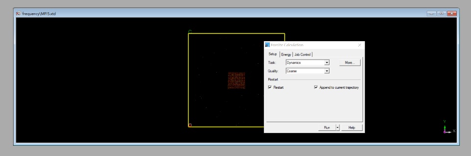

When I use the 3D Atomistic Trajectory document as the input document to restart a dynamics through UI, it runs well, as shown in these two figures before:
The step is 18001100 and the temperature of my system is 378.842K, as shown below, that is corresponding of my previous data

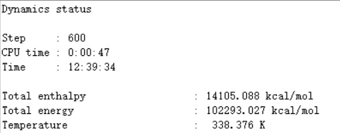

However, when I use perl script to do this job, my perl script is shown below:
#!perl
use strict;
use Math::Trig;
use MaterialsScript qw(:all);
my \\\$doc = \\\$Documents{"MFI5.xtd"};
my \\\$totalTime1 = 3600; # ps
my \\\$interval = 360; #ps
my \\\$forceAmplitude = 507.5; # kcal/mol/A
my \\\$forcite = Modules->Forcite;
my \\\$dynamics = \\\$forcite->Dynamics;
my \\\$xtd = \\\$dynamics->Run(\\\$doc, Settings(NumberOfSteps => 1))->Trajectory;
Modules->Forcite->ChangeSettings(Settings(
TrajectoryRestart => "Yes",
AppendTrajectory => "Yes"));
for(my \\\$time1 = 0; \\\$time1 < \\\$totalTime1; \\\$time1 += \\\$interval)
my \\\$force1 = \\\$forceAmplitude*(\\\$time1/\\\$totalTime1);
printf("%12.6f %12.6f\\n", \\\$time1, \\\$force1);
my \\\$externalForceStrength = \\\$force1;
my \\\$results = \\\$dynamics->Run(\\\$xtd, Settings(
Ensemble3D => "NVE",
TimeStep=> 2,
InitialVelocities=>"Current",
NumberOfSteps=>180000,
TrajectoryFrequency=>180000,
CurrentForcefield=>"Dreiding",
Quality=>"Coarse",
ChargeAssignment=>"Use current",
ExternalForceSet => "Top",
ExternalForceStrength => \\\$externalForceStrength,
ExternalForceX=>0,
ExternalForceY=>-1,
ExternalForceZ=>0,
CounterExternalForce=> "No"
The step is only 600 and the temperature of my system is 338.376K, as shown below, which is not correspending with my previous data,what's wrong about my script? Thanks.
