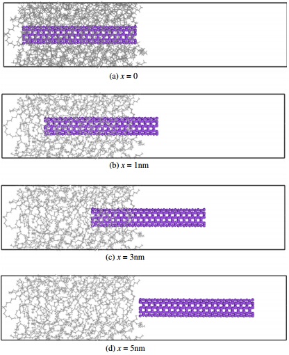

I want to perform a pull-out test in forcite or mesocite, how to do?

I am assuming by "pull", that over time you want to pull the nanotube away from the other material as you run a single dynamics job. I think that there are two possibilities
1) Create a position anchor and then attach one or more harmonic restraints to the nanotube. Restraints and anchors are scriptable and documented.
2) Apply an external force to the nanotube. Look up ExternalForceStrength in the documentation, but basically you define a set (of atoms or beads) that you want the force to be applied and use ExternalForceStrength, ExternalForceX etc to define the Force.
Unfortunately these two methods will move the nanotube, but not a constant velocity. The restraint method in particular is likely to distort the nanotube i.e. the atoms where you attach the restraint(s) to will tend to move before the rest of the nanotube.
If you want to simply translate the nanotube and then run dynamics, as one "pull distance" and repeat at other distances then that is easy to achieve via scripting. I would define a set of atoms from the nanotube to easily identify the nanotube, obtain the coordinates, adjust the x ordinate and run dynamics. This would result in multiple trajectories, one for each "pull distance".
