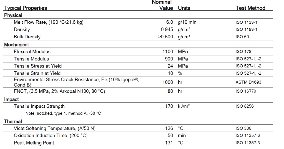

Steps i follow to create polyethene: build polymer > homopolymer > olefins (ethene) > create
using this step the calculated density of polymer is 0.87 g/cm3. (density i got from synthia module, even the branching are zero, penalty no. is 1)
my objective is to create a HDPE polymer which has density around 0.92 g/cm3.
my overall objective is to create HDPE polymer which has properties as mentioned in TDS, given below (technical data sheet).?

HDPE is highly crystalline, around 60% according to wikipedia. The value from Synthia will be for the amorphous part.
An experimental crystal structure of polyethylene can be found in Structures\polymers\crystalline\ethylene.msi. It has a density of 1.00769 g/cm³. Thus, assuming a crystallinity of 60%, the overall density will be around 0.6*1.00769 + 0.4*0.87 = 0.95 g/cm³, close to the value of 0.945 g/cm³ on your technical data sheet.
Simulation cells are usually too small to include both phases; it might be better to study them separately and average the results afterwards.

Another way to generate the data which is given in above TDS is:
  1. create ethylene polymer
  2. construct Amorphous cell of desired density
  3. optimization & relaxation of cell
  4. determine mechanical properties using forcite module
  5. validate the properties with data sheet.
Please give suggestion if my approach is correct.
​​​​​​​otherwise create crystal structure of ethylene and approach the desired density by changing lattice parameter. > perform mechanical properties test > validate result
