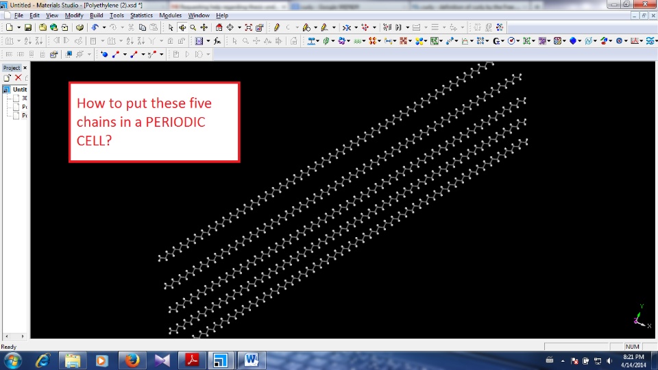

Our challenge is to build an amorphous polymer matrix of Polyethylene with correct density and zero stresses. (figure 1 - attached below). First we have to construct a periodic cell with 5 chains of PE molecules with 50 repeat units each with initial density 0.1 g/cm3. Then to perform geomtry optimizaitons, NPT, NVT dynamics etc.
But we are facing some basic problems and could not solve them.
1. How to construct a periodic cell with 5 chains of Polyethylene molecules with 50 repeat units each with initial density of 0.1 g/cm3? Which options ( Build/ Modify/ Modules/ Tools ) to use for the construction purposes?
We can build 5 chains with 50 repeat units. ( figure 1, attached below). But we could not put them in a cell. How can we put those 5 chains in a cell ? How to make them periodic?

I think that you could achieve this using the amorphous cell module. First construct your single chain with 50 repeat units and then use amorphous cell module to pack 5 of these into a cell at the specified density. There is help on this Module withing the MS documentation.
Once built you could use Forcite module and the geometry optimization and Dynamics tasks.

Thanks for your reply. Really it's working!!!!!!!!!
