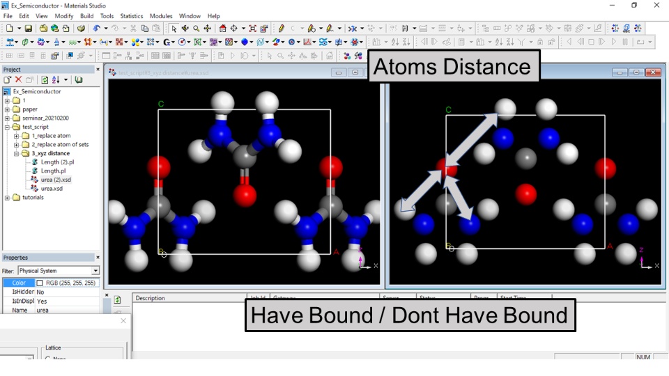

I am currently trying to find the shortest interatomic distance in a cell.
This is because we are trying to predict the electrical properties of metals and crystals from that value (although there are others).
I think sample file of Materials Script(ex. CalcUniqueBondLengthAngles.pl), but this code wasn't helpful as it's supposed to contain join information(use "collection = source->Bonds").
How to calculate the minimum distance between atom(Atoms Distance under fig.)??
Thank You!

I write this code.
This code's flow is
"select two atoms -> calculate distance -> remove Duplicate value"
However, this code is heavy because it calculates (ex. A_B and B_A) for all combinations.
Can you give me some advice on how to improve this code and make it lighter?
