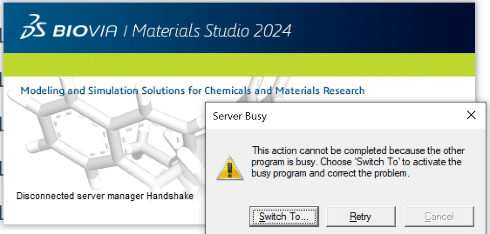

Dear All,
I am running a DMol3 simulation while I ran into this issue.
The "Server Busy" pop-up obstructs all actions, and returns after clicking retry or the X button. This pop-up persists upon restarting Materials Studio.
May I know if anyone else has encountered this issue and how to resolve this?

CM 2024-11-25 Best Answer
Please make sure that the Materials Studio gateway is really up and running.
This also may occur when the DMol3 job is too large for the server and it is heavily swapping.
Another reason for this is that the connection to the remote gateway is to slow.
Too many remote jobs running at the same time can be a problem as well
All in all there can be tons of reasons for this.
Sometimes it helps to wait a few minutes and then to hit the retry button.
Are you able to connect to the gateway using a browser?
On can manually kill the dsmgr.exe (Disconnected Server Manager). The Materials Studio Visualizer should come up then but you well not be able to properly connect to remote jobs.
Things seem have to be changed a bit. When doing a remote view on the job the Disconnected Server Manager is restarted (may results in hangs as well, sometimes on has to be patient).
Which Materials Studio version is this?
Which Windows version is this exactly (What does winver say (https://support.microsoft.com/en-us/windows/which-version-of-windows-operating-system-am-i-running-628bec99-476a-2c13-5296-9dd081cdd808 )?
Is this a 32bit or 64bit Windows version?
