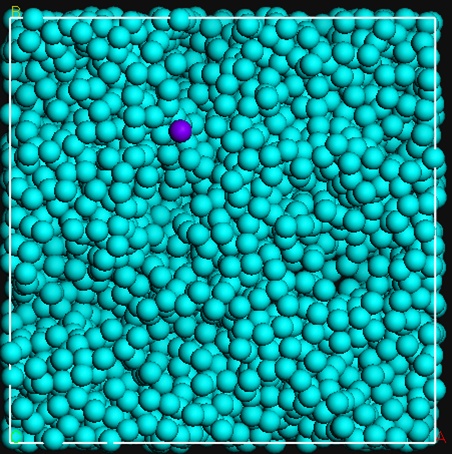

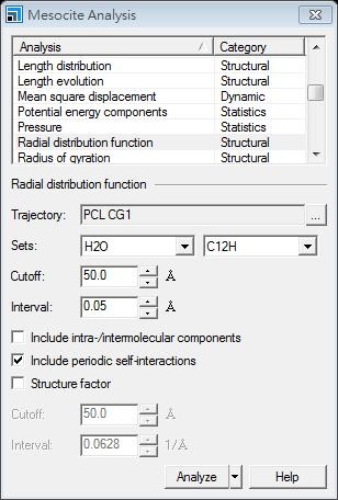

I analyzed the radial distribution function of CG beads system(fig.1).
Fig 1.H2O beads are blue and C12H beads are purple.

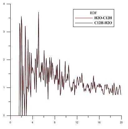

I got the result which set up the sets (left) : H2O; (right) : C12H (Fig.2).

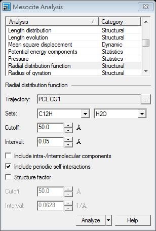

I got the result which set up the sets (left) : C12H; (right) : H2O (Fig.3).
I think the results should be different because the system had many H2O beads and only one C12H bead. However, I found these two radial distribution functions are the same.
I would like to know what cause the same of distribution.

Hi Martin,
The radial distribution function is a distribution of pair distances; the order of beads doesn't matter. Whilst a C12H bead has many H2O neighbours, there is just one instance. On the other hand, a H2O bead has just one C12H neighbour but there are many instances. The net result is that there are as many C12H-H2O pairs, as there are H2O-C12H pairs - the order just determines how to find them.
Hope this makes sense.
Reinier
