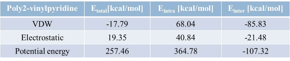

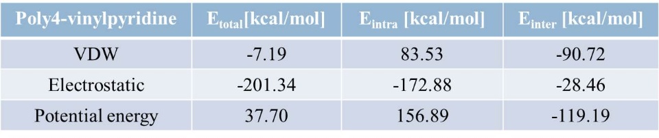

I calculated the cohesive energy density of two atomic systems(Poly4-vinylpyridine(P4VP) and Poly2-vinylpyridine(P2VP)).
    Poly4-vinylpyridine(P4VP)                   Poly2-vinylpyridine(P2VP)
The two systems have one chain including twenty P4VP and P2VP monomers.
I found inter energy of the two systems are little different but total energy and intra energy of the two systems are quite different.
I would like to know what cause the difference of energy.

Hi Martin,
It might have something to do with the distribution of atomic partial charges within the polymer molecules. Are there some like charges in close proximity in the P2V molecule? If this is the case, it should show up for non-perioidic single polymer chain calculations as well.
