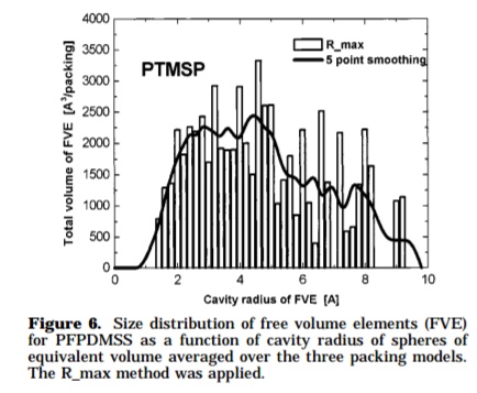

I am looking for a tool to calculate the free volume element distribution suggested by this paper. (Hofmann, D., et al. "Free volume distributions in ultrahigh and lower free volume polymers: comparison between molecular modeling and positron lifetime studies." Macromolecules 35.6 (2002): 2129-2140.) The result is like below one.
Does anybody know if Materials Studio implement this algorithm? I am considering to buy this software if it has.

You can use a spherical probe of a specified radius to generate a Connolly or solvent isosurface that encloses the free volume in the system. You can then divide the free volume into segregates and analyze their distribution. The method used for dividing into segregates is by defining a surface around them of constant field value - usually the mean value of the free volume field. The is probably more similar to what V_connect does then R_max, since the former just cares about connectivity and is tolerant of 'wormlike micelle' voids.
The tools are available to code your own analysis that is along the lines of R_max. You have access to the free volume field and segregate objects at the scripting level. You could conceivably define your own segregation method via a script.
