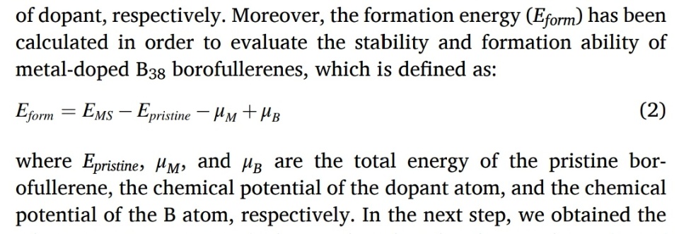

I want to calculate formation energy with the formula in the attachment but I dont know what is chemical potential and how can I calculate chemical potential?

Hi Zahra Entezarian,
According to my understanding, this process corresponds to the insertion of a dopant atom and to the extraction of a boron atom. The "chemical potential" value here is the energy level of the dopant/boron atom in the outside phases from which they are being transacted. In a simple case where the dopant is a crystalline solid, in a dopant-rich environment the chemical potential of the dopant is the energy of the dopant atom in its pure crystalline phase, for example.
The below relation holds (it is a condition for equilibrium):
chemical potential of inserted dopant and boron pair = chemical potential of dopant + chemical potential of boron.
In literature, I've seen authors calculating the pair chemical potential as the energy per pair of atoms in a pristine stoichiometric crystal. Using the above relation that allows to recover the chemical potential of boron in a dopant-rich environment.
I have seen others simply considering that both the chemical potential of the dopant and of the fullerene atom under study are the energies in their pure crystalline phase, but I do not know if that choice makes sense given the above equilibrium condition.
However, I am not expert in this area. I encourage you to take a look at the reference states you are interested in for your particular application in order to choose the best one for your calculation.
