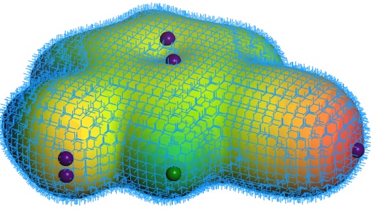

An example below demonstrates the output from this script.
Here you can see the blue U atoms indicating the outline of the electron density isosurface with green and purple atoms showing maxima and minima.
