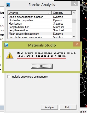

I was calculating MSD and RDF between some specific atoms in a trajectory, I follow these steps to achieve this task:
    (1) Define a set. Draw a structure unit in a .xsd file→ Find patterns based on "ElementType"and then click "new sets".
    (2) Choose a set. Edit sets→“select”.
    (3) Run Forcite→Analysis→MSD or RDF. Then a messagebox appeared,"there are no particles to work on"
There must be something wrong with my operation, can someone help me to solve this problem?

The error message means that the RDF or MSD has no atoms to work with. Most of the analysis functions requires atoms to be either defined in sets or by selection, so most likely your set does not contain atoms.
I would start by checking that your input set is correct. Suppose your set is called MySet. With the structure that you want to be analyzed open the edit sets dialog and click on MySet and then click on Select. You should see atoms corresponding to your set selected in the model. If you have anything but atoms selected e.g. measurements / monitors then the set is not suitable for Forcite MSD/RDF analysis and you need to define the sets again.
Assuming all is ok, deselect everything, by for example double clicking on empty space in the model and then open Forcite analysis. Select Mean Square Displacement in the list and then in the drop down choose MySet and then click Analyze.

    I’m very excited to see that the MSD or RDF calculation worked.
    The key for this problem is just select "Select Substructre Items" after right click the "neted" atoms!

Thanks for your reply. I checked the operation following the steps you mentioned, and, unfortunately, the same error occured.
I checked the selected atoms in the structure and found that maybe the atoms in a set were not "really selected", they were just "wrapped" by a small net. I tried select atoms based on Atom Selection and calculate MSD, then it work.
Actually I just want to select the end phenol rings of polymer chains, and maybe the way of "Find Patterns→New sets" is not a good choice, Do you have any advice for this question?

Can you post the structure (as . xsd file) with the set(s) defined on it and the name of the set that you used.

Here is a test file named"test.xtd" which contains 10 frames. Every frame containes 8 polymer chains randomly ditributed.
  • A pattern file named "pattern.xsd" was constructed,
  • then "Find Patterns",
  • after choose the pattern file and "Element Type",
  • →"Find"→"New sets",
  • then named it "myset".

The set named "myset" does not contain atoms, but a substructure. I think that after you have run the pattern matching tool and before creating the set, right click in the document and choose the option that selects the atoms contained in the substructure. Sorry, I can't remember the exact name, but it will probably be obvious when you see the options and it will be documented in the help.
