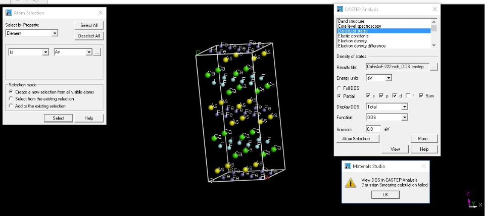

Dear All,
I am getting following error in partial density of states (PDOS) analysis using CASTEP (material studio interface),
View DOS in CASTEP Analysis
Gaussian Smearing calculation failed
I have used OTFG-Ultrsoft Pseudo-potentials and there are no error messages in my calculation. What are the possible causes and what is the solution?

Hi SG.
This issue is very interesting
I would like to reproduce and verify the problem myself. Is it possible to upload a file(Inputfile(calculated file) and outputfile(results file))?
SG
SG 2020-11-13
Please find the attachments.

Hi SG.
Thank you of attachments.
I see this attachments.
Curiously, I couldn't press the button(CASTEP Analysis > Density of states > View) in this file. So, I would like to calculate with rough accuracy using the attached xsd file from now on.

Hi SG.
I calculated DOS using your attachments structure.
My calculation couldn't reproduce the error.
Attachment my results.
I think, it seems that the job starting is not going well.
comment imagecomment image

VM
VM 2020-11-15
Hi, the files are not sufficient to reproduce the problem, on needs also castep_bin and pdos_weights binary files. They might be too big for the upload, but maybe you could try attaching those.

SG 2020-11-16
Hi Victor, please find the attachments. I am also trying from my side to solve the issue as per TK's suggestion.
VM
VM 2020-11-17
Sorry to say, but I can't reproduce this error using your files. Both MS 2020 and MS 2021 (in development) cope well with your results. By the way, you have plenty of k-points in the calculation, so for production purposes I'd recommend to use Interpolation option in the DOS calculations, not Gaussian smearing.
SG
SG 2020-11-18
Dear VM, I have tried the interpolation option already, and failed. I am using MS 2019. There is an impose symmetry option (Build > Symmetry > Find symmetry > Impose symmetry) in MS, if I use this this error does not occur. I do not understand why?
VM
VM 2020-11-18
I am afraid I cannot help further, since the error doesn't occur for me in the P1 setting. One thought is that perhaps there is not enough memory on your Windows computer; P1 setting would have more k-points and hence require more memory.
