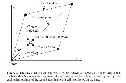

Are the elastic constants calculated from CASTEP "relaxed" or "unrelaxed"? For instance, in a hexagonal cell,  is the additional nonequivalent atom (the one labled with arrows) relaxed from the position imposed by the homogeneous strain in CASTEP geometry optimization for Cij calculation?

CASTEP does exactly what online documentation promises: "CASTEP minimizes internal coordinates for each distorted structure while keeping  the lattice parameters fixed." You could apply tricks to extract the unrelaxed values, they will be all about playing with the input files.
