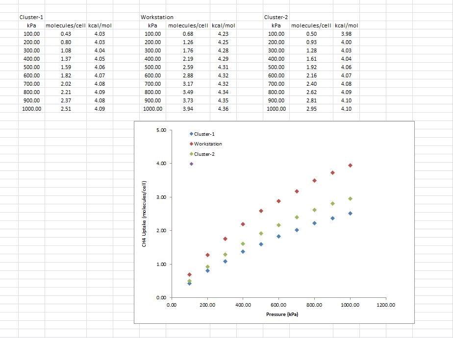

We are able to use Materials Studio both on our workstation and on a cluster through a gateway. I notice a difference between the results when I submit the same simulation in both of these. I submitted the same job on the cluster two times to make sure that if the results would change when I submit it again in the cluster but it did not differ as in workstation.
Does anyone encounter the same or has an idea about it?
Thank you.
The results are like this:

What happens if you redo the run on the machines?
What happens if you allow more equilibration steps?
I have to admit that this perhaps just numerical noise.
I use 2017 version of Materials Studio so only the last update is not done yet.
When I redo the run on the workstation I obtain matching results and when I redo the run on the cluster I have again matching results. However, between the results of the cluster and the workstation there is a difference, like for CH4 adsorption at 10 bar:
on workstation : 3.96 molecules/cell
on cluster : 2.53 molecules/cell
I tried with 5 million and 10 million equilibriation steps but it did not fix the problem.
