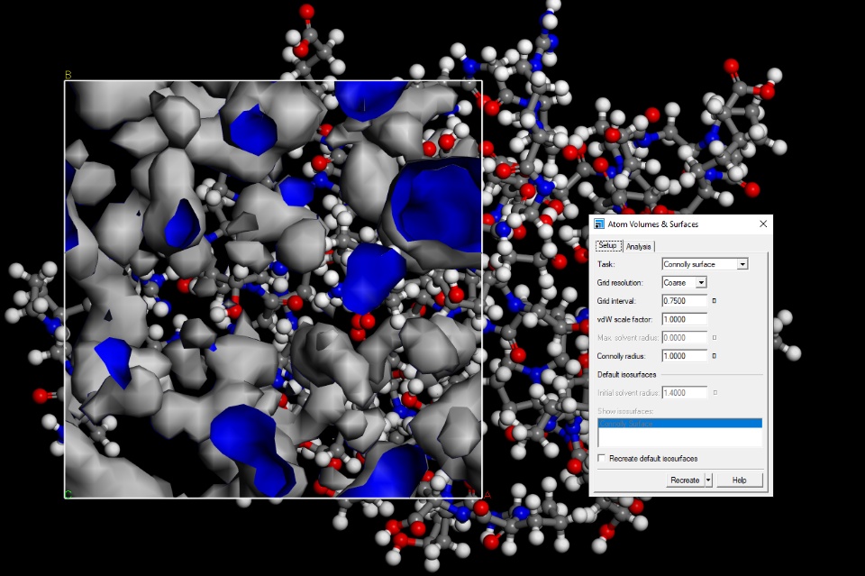

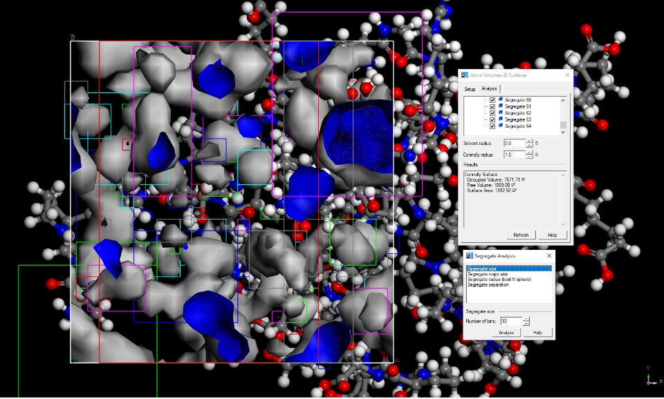

I want to write a script that analyses distribution of voids in a polymer. I can perfectly do this from the level of MS GUI by performing following steps:
1. Tools/Atoms Vol and Surf/Connolly Surf (default settings)
2. Create Segragates
3. Analyze Segregate Field/Segregate Size

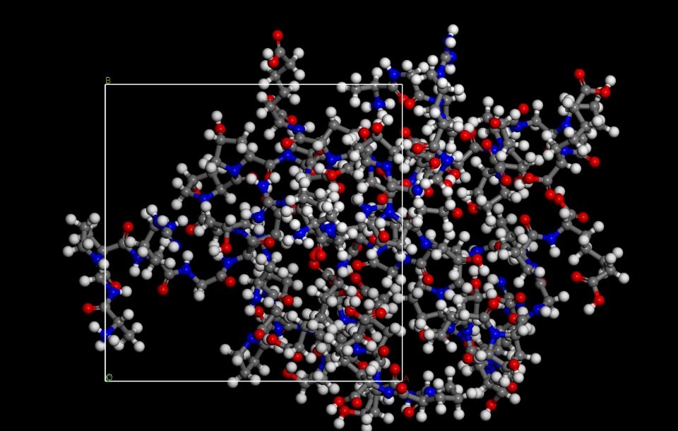

I attach screens initial structure->volumes->segregates
I was trying to do this from the level of scripting. I can create volumes, segregate but no segregates not mentioning the analysis. Please help
