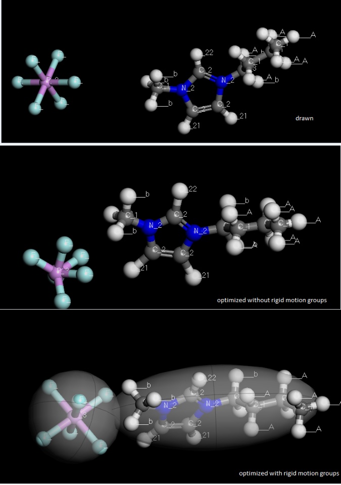

Hello,
I need to model an ionic liquid in Materials Studio ([BMIM][PF6]). I have drawn it, assigned its charges and the force field. The problem is that I want to have the anion and the cation in a position that has the minimumm energy but with Geometry Optimization tool only the position of the intramolecular bonds are changing and the position of the anion and the cation is the same where I have drawn, it does not ever put the anion at different locations with respect to the cation,at most they get closer. Is there any tool in Materials Studio which can try different conformations of anion and the cation and decide the one with the lowest energy?
I have one last question also. While doing geometry optimization, if I do not keep the motion groups rigid, the last conformation is not logical. Does anyone have a suggestion about this? I set the quality to ultra fine and  I have increased the number of  max. iterations to 50000000,but the convergence criteria is not satisfied.
I have attached the pictures of the all the ionic liquids as I draw, geometry optimized with and without rigid motion groups.

It looks if you are using Dreiding with your own typing. I will leave the decision if that makes sense to you.
Dreiding does not know about the PF6 anion.
The only force field in Materials Studio which knows about PF6 is COMPASSII (not keeping UFF in mind).
One can use the Conformers module (the CH3 Groups may have to be included but only for a torsion range 0-.120°) to generate a trajectory which can then be used in Blends using the Binding Energy Task to get a trajectory with the lowest energy frames which then can be further optimized or use the Adsorption locator from the beginning
-> There are lots of possibilities.
If just the PF6 anion is treated as motion group/rigid body one can perhaps give Dreiding a try.

 I used a forcefield mentioned in a computational work which inserts ionic liquids in a metal organic framework. For the cation they use AMBER forcefield and for the anion they use parameters mentioned in another article. However, to assign these parameters to the ionic liquid in Materials Studio, I had to edit a forcefield with Materials Studio, and so I choosed Dreiding and alter the energy and distance parameters in the "Types" section but I did not change anything in Interactions and Equivalences sections. Is this mistaken?
Also, maybe it is not enough to draw the ionic liquid and make Forcite Geometry Optimization, right? Because it takes just seconds no matter how much I increase the quality and I do not think that the structure I draw is that close to the optimum structure.
Actually, I just want to create an ionic liquid, optimize its structure and insert different number of these ionic liquid into a metal organic framework. Should I follow this path at the end of your reply?
I am sorry for my long reply. Thank you for your help.

What you did, it sounds like, is to change just the vdw interactions. The results are completely unpredictible as you are using interaction parameters from two different forcefields.
I would use COMPASSII rather than trying to hack your own forcefield. It extended COMPASS to ionic liquids. PF6- was part of the training set that included 30 anions and 74 cations. A new angle potential is used to get the octahedral geometry.
Then you can use the Sorption module to insert the ionic liquid fragments into your MOF.

COMPASSII should be used for the complete system. As Jason wrote: Mixing parameters from different force fields might not be a very successful approach anyway.
The problem I see is that you MOF quite likely is not covered by COMPASSII

Then, I will try to use COMPASS II for the whole system. So far I have geometry optimized the MOF and the ionic liquid with this forcefield and they did not give any error, the last structure of the PF6 anion is as we wanted to see. Only, in the case of ionic liquid there is a statement like "Inconsistent force constants for MEAN WILSON inversions encountered. This should be remedied by ensuring that all JKL permutations for such inversions are present in the parameter file, with identical force-constants." but I used that structure anyway.
Now, I have load the ionic liquid into the MOF with Fixed Loading in Sorption module.
I am trying to reproduce a previous work therefore I insisted on  using their parameters, and the only way seemed to be to edit a forcefield  but now I have understood that I was mixing the parameters of two different forcefields with this way.

As assumed. COMPASSII does not have parameters for the MOF:
Energy contributors with missing parameters:
Bond Stretch : (o_m zn2o), (zn2o o)
Angle parameters are missing as well. Unless the MOD is fixed the MD runs and geometry optimizations are doomed to fail and to give nonsense.
I suspect that the charger can be pretty much meaningless as well.
It is not possible to read/extract the parameters of COMAPSS or COMPASSII.
According to my opinion you realty set up and parametrize your own force field properly or use UFF where you have to find a way to get consistent  partial charges.

I do NOT get the inversion message for the ionic liquid (PF6 + BMIM). That would indeed be a problem.
It is not surprising that the zinc-oxygen bond parameters don't exist as well as associated angles and torsions. I doubt there are any bond parameters for the zn2o forcefield type. That is meant for zinc oxides which use the ionic model (only nonbond interactions). So really this message is not a sign that anything is amiss. The tests you ran show that the structure holds together well, but the cell increases in size by 1.8A in each direction (about 25% in volume).
The good news is that Sorption holds the framework fixed and simply searches for sorbate positions that have a low energy. So given that COMPASSII supports all of the nonbond interactions in your MOF + BMIM + PF6 system, it should be ok to use. That is a relief because it is really a lot of work to edit to build a forcefield yourself from a paper.
I would note that the Universal forcefield is generally not a good choice (unless you have no other options). In the case of PF6, it uses a tetrahedral angle for P. So that is not good. It actually has two minima for the octahedral and tetrahedral conformations.

You may be able to use it for sorption runs (has to be validated according to my opinion) but not for further geometry optimization or MD runs with COMPASS or COMPASSII as forcefield.
JD
JD 2016-01-15
CO2 and N2 are covered by COMPASSII as well. So everything is covered.
Now if you really insist on using the forcefield from the paper, that is your choice. But you will have to translate all aspects of the forcefield into MS (for the atoms of interest). You should not mix forcefields. So you should start from scratch from an empty forcefield document. You will also have to manually type your atoms.
