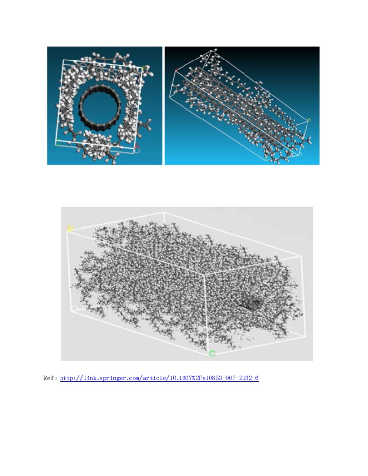

Dear All,
I am going to study the Mechanical properties of CNT/Polymer composite using MD simulation. I am trying to construct the CNT/polymer composite as shown in the attached word file. A CNT surrounded with polymer. Can anyone help me with this task? The figure also could be found here: http://link.springer.com/article/10.1007%2Fs10853-007-2132-6

Hi Mohammed,
Here is how I would build that:
1) Build a periodic carbon nanotube
2) Edit the lattice parameters, without keeping fractional coordinates fixed. Enlarge the space in x and y and make the box ortho (gamma=90).
3) Build a supercell, muliplying the Z by about 10 to 20, depending how long you want the tube to be.
4) Optionally center the nanotube in the box (e.g. create centroid and change centroid coords)
5) Use Amorphous Cell Packing task to add polymer
