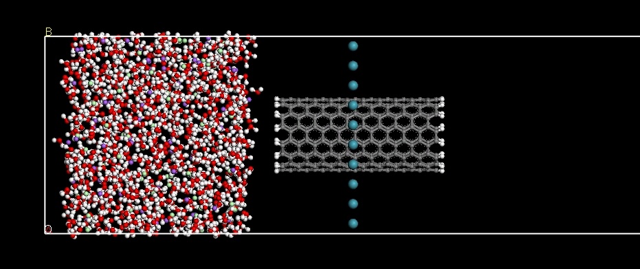

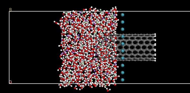

Dear all,
I'm trying to construct an impermeable wall to prevent passage of water molecules outside the CNT because I want them to pass only through the tube. I used a layer composed of Xe atoms and deleted the atoms which fall inside the CNT. However, when I applied NVT-MD, I realized that Xe atoms outside the CNT also affect the inside and molecules still act like there is a wall and they don't pass through the tube as you can see in the figures. When I remove the wall, they do pass. What could be the reason for this? Is it about Xenon? What can I use instead?
I would be really grateful if you could help me.

I would say that this is perhaps no the structure whihc is seen in the screenshot? At leas the position of the He layer is different.
Could you please also post the force field file?
I have at least some ideas whet might go wrong:
  • Perhaps the interaction with the He centers is to strong and that prevents the water phase to move on.
  • The energy of leaving the water phase into the CNT is higher than that the additional force can do.
  • What happens if a larger force is applied?
  • What happens when only one water molecule is used?

Thank you so much for your ideas. You are right, the images and and .xsd file are not the same. I tried the .xsd file that I attached first, then I thought hydrogens bound to CNT end can keep water molecules. I slided the Xe wall to the middle. I saw that water molecules can actually enter the tube, but they can proceed only until they get close to Xe wall.
I didn't suprise that COMPASSII has worked, thank you for trying. I tried Universal and it worked, too. But I need to use TIP3P parameters to model water molecules, that's why I use an edited forcefield.
I also tried applying much higher force, up to 500 kcal/mol/A. Water molecules gets closer to wall but they don't pass.

I tried to put a single water molecule, to remove the wall and to remove the wall and CNT together. In those cases, water molecules pass very quickly suggesting that the force I appy is more than enough. I also tried another element, I placed a graphene sheet instead of Xe wall, this wall also prevented the motion. I am posting my forcefield file as attachment.

Keep in mind that the total external force is divided equally among all atoms in the set. I have found that it takes a force of about 10 kcal/mol/A to overcome cohesion and pull a water molecule out of the liquid phase.
In the attached example, I tried to make the simulation a lot faster, so I could easily play with the parameters. So I deleted the salt so I can switch to group based charges and I deleted all but 200 waters. For the external force, I used 2000. I also wrote the trajectory frequently every 50 steps so I could see what is going on.
The simulations usually end prematurely as molecule slam against the wall.
