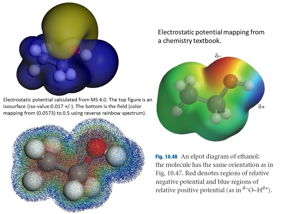

I am having difficulty constructing electrostatic potential surfaces for organic molecules (ethanol).
The mappings I construct is shown below. It is quite different from that shown on the web or in the textbooks.
Please provide an expert opinion as to how I can modify this in MS 4.0. I want my surface to be continuous as in the one shown in the textbook.

Hi
you are using an isosurface, e.g. you are plotting regions of constant potential. The reference figure was done by using another surface (e.g. constant density surface, van der Waals surface, connolly surface, COSMO surface etc etc etc) and then mapping the potential onto it. For more details, please check the help for Display Style -> Isosurface -> mapped field.

See also
Tutorials > Visualizer tutorials > Working with isosurfaces and slices
