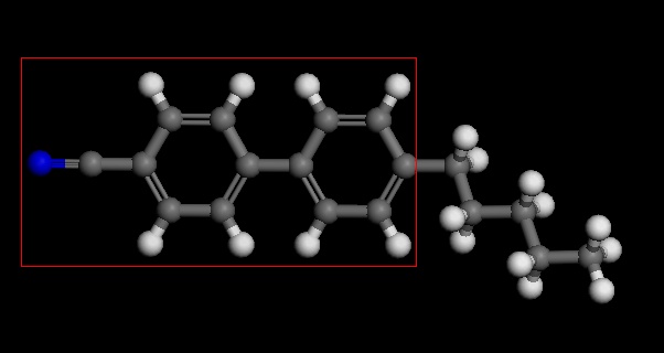

I want to construct a coarse grain model for a liquid crystals molecule (5CB). It has a Cyanobiphenyl group (In red box in the attached picture).
In Build Mesostructure the only option available is to define radius. As in literature, this Cyanobiphenyl group has to be modeled as ellipsoid/cylinder.
For this purpose I need to define length/width (L/D) ratio.
If MS can do it please somebody help me.  I am using MS 4.3.

Hi Anant,
Unfortunately it is not possible to define aspherical beads. Also the force fields are limited to central interactions. To achieve asphericity you could try modeling the group as multiple beads, subject to a stiff angular interaction.
Note that the bead radius is only used for display (in CPK), and does not impact the calculation.

RA 2012-11-08
I am not sure how well such a model would reproduce Gay-Berne (GB) behavior, but you could have a look at the way people have parametrized the GB model. For example, the paper below determines GB parameters for a polymer; you might be able to do something like that using the "beads-on-a-line model" instead
C.K. Lee, C.C. Hua, S.A. Chen, Parametrization of the Gay–Berne potential for conjugated oligomer with a high aspect ratio, J. Chem Phys. 133, 064902 (2010) (link).

Dear Reinier,
Thanks for your reply.  Actually, I want to build an anisotropic Gay-Berne Model fo liquid crystals. Will "the grouping of multiple beads" serve as a nearby model?
