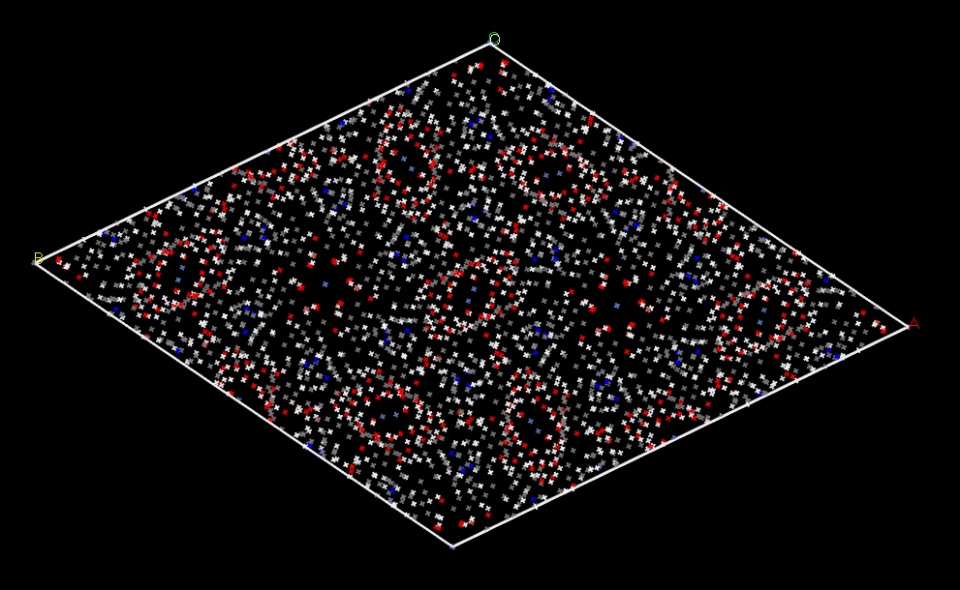

I have a question related to CIF visualization. Some of the CIFs don't show connectivity when I import to MS (please see the attachment). Is there a way that I can include the connectivity? Some other CIFs don't have any problem though.

Hi, to my knowledge the CIF file contains optional bonding information which is displayed when available. If no bonding information is available, you can simply click click on "Calculate Bonds" or Build | Bonds | Calculate on the main menu to solve this using Materials Studio's internal bonding scheme.
