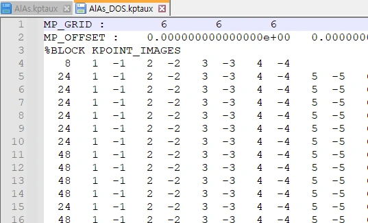

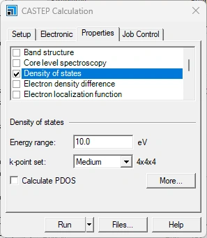

For both the SCF and DOS calculations, I explicitly set the k-point grid to 4×4×4. However, when I check the result file (specifically the .kptaux file), it appears that the SCF k-points are listed as 4×4×4, while the DOS k-points are shown as 6×6×6.
I’ve attached screenshots showing the k-point settings used in the calculation as well as the relevant part of the .kptaux  file for reference.
Why is the DOS calculation using a 6×6×6 grid when I clearly set it to 4×4×4?

Hello, if you look at the pictures of your CASTEP panels, you'll see that k-points for the SCF part are set as "customized," while the DOS setting is controlled by quality. My theory is that when you saved files, you were asked to convert the cell to primitive, and you accepted this suggestion. In this case, the SCF points stay as they were, while the DOS points will correspond to the desired quality (Medium) for the primitive unit cell. Could you please check this theory?
