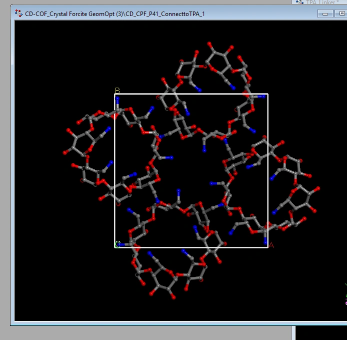

I am still trying to build the cyclodextrin COF in MS form this paper-
I built the crystal lattice parameters (for a P41) based on this paper then pasted in an optimized beta-CD which brings me close to the structure (alpha helix packing inside the unit cell).
However I am having trouble connecting the TPA ligand in a way that gives me the correct structure to generate the correct pXRD.
Thank you in advance for anyones help!

Are there hydrogen centers added or do you just hide them?
Could you please do the following in Materials Studio:
1. Close all documents in Materials Studio.
2. Make a clean directory
3. Copy the .xsd file from which the Forcite Geometry Optimization was started into the new folder.
4. Copy the folder with the Forcite Geometry Optimization into the new folder.
5. Zip the new folder.
6. Add the resulting .zip file to the SR.
CM
CM 2026-03-25
Please check if the rings overlap:
1. Change the display style for the lattice to 2x2x2
2. Change the display style to CPK.
3. Color the atoms by molecule
Please also calculate close contacts smaller than 1 \AA
When simply copy-and-pasting it into a cell with P41 symmetry I get  tons of overlaps.
I suggest to also have a look at the Polymorph Predictor module in Materials Studio
